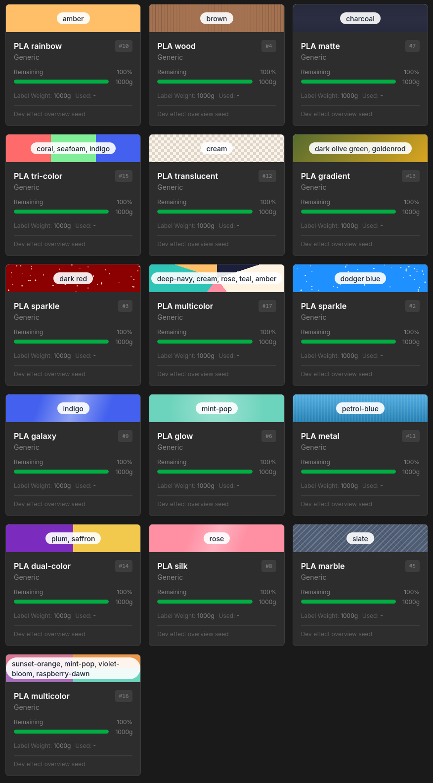

Effects¶
Effects can be use to give a visual hint on the filaments look, covering:
- surface effects (Sparkle, Wood, Marble, Glow, Matte),
- sheen variants (Silk, Galaxy, Rainbow, Metal, Translucent)
- structural variants (Gradient, Dual Color, Tri Color, Multicolor).
They are rendered on top of the colour swatch, using the information from Extra Colours — effects do not change the slicer profile or anything the printer sees.
Colour lists for multi-color filaments can easily be gathered from a site like 3dfilamentprofiles.com and pasted into the Extra Colours field.

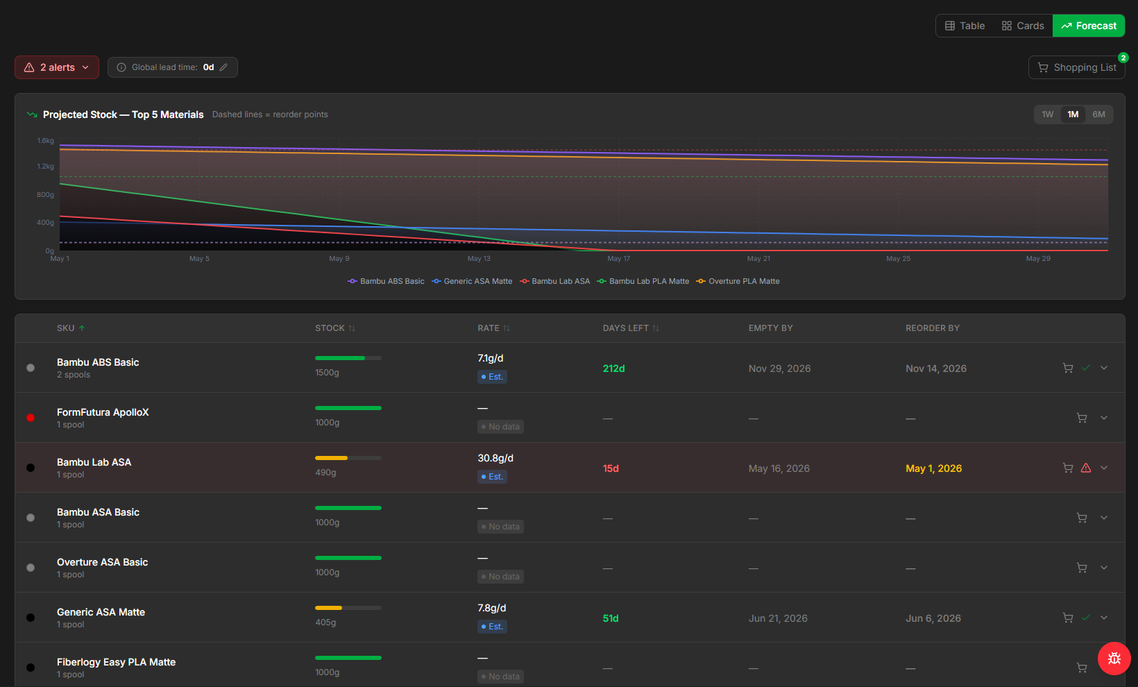

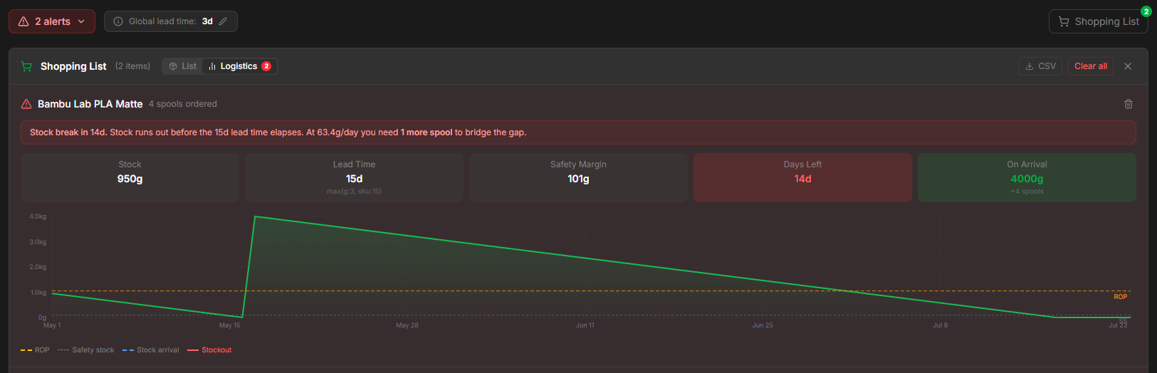

Inventory Forecast¶
See inventory depletion rates based on material usage and handle stock logistics.
Forecasting¶
The Forecast view shows all Inventory spools. Identical spool types are grouped together.
