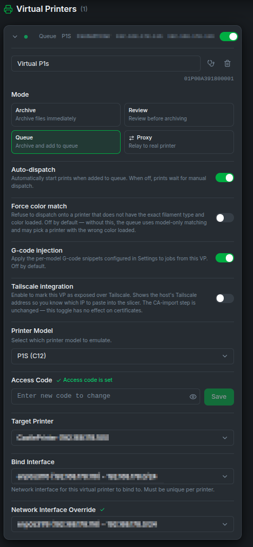

Modes
The virtual printer supports four modes:
Mode Description
Immediate Files are archived automatically when received
Review Files go to pending uploads for manual review before archiving
Print Queue Files are archived AND added to the print queue (unassigned). Four optional toggles:
  • Auto-dispatch (on by default) — incoming prints start automatically when a printer is free; turn it off to require manual dispatch.
  • Force color match (off by default) — the scheduler refuses to dispatch onto a printer that does not have the exact filament type and colour loaded. Without it, the queue uses model-only matching and may pick a printer with the wrong colour.
  • Save AMS mapping (off by default) — keeps the AMS slots the slicer itself resolved, instead of letting Bambuddy re-derive them from the file's filament type and colour. See below.
  • G-code injection (off by default) — opts this VP's incoming Send / Print jobs into the per-model auto-print G-code injection, applying the start/end snippets configured for the target printer's model.
Proxy Forwards traffic directly to a real printer (remote printing)
A Print Queue mode virtual printer showing the Auto-dispatch, Force color match, and G-code injection toggles

Setup — per VP
  1. On the VP card, flip Tailscale integration on.
  2. Within a few seconds, the card shows 100.x.x.x (your-host.<tailnet>.ts.net) with a copy button.
  3. Paste that 100.x.x.x (or the MagicDNS hostname) into your slicer's Add Printer dialog.
  4. (One-time) import Bambuddy's CA into the slicer if you haven't already.

Configuration
Creating a Virtual Printer
  1. Complete the platform setup above first
  2. Go to Settings in Bambuddy
  3. Scroll to the Virtual Printer section
  4. Click Add Virtual Printer
  5. Set a Name for this virtual printer
  6. Choose your Mode: Immediate, Review, Print Queue, or Proxy
  7. For Proxy mode only, choose the Target Printer
  8. Click Create
    Those are the only fields in the dialog. Everything else is configured on the virtual printer's own card, which appears in the list underneath.
  9. Choose the Printer Model to emulate
  10. Set an Access Code (exactly 8 characters) — not needed for Proxy mode
  11. Pick a Bind Interface — the dedicated IP address this virtual printer listens on. The dropdown lists one entry per IP address, not per adapter, so a single network card carrying several addresses gives you several choices. See Dedicated Bind IP below for how to add those addresses.
  12. Toggle the card to Enabled — a virtual printer with no bind IP will not start
You can create multiple virtual printers, each with its own mode, model, and bind IP. They appear as separate printers in your slicer.

Printer Model Selection
Choose which Bambu printer model the virtual printer should emulate:
SSDP Code Printer Serial Prefix
3DPrinter-X1-Carbon X1C (default) 00M
3DPrinter-X1 X1 00M
C13 X1E 03W
C11 P1P 01S
C12 P1S 01P
N7 P2S 22E
N2S A1 039
N1 A1 Mini 030
O1D H2D 094
O1C H2C 094
O1S H2S 094
Model Change
Changing the printer model will automatically restart the virtual printer. You may need to re-add the printer in your slicer since the serial number changes.
Network Interface Override
Multi-NIC / Docker / VPN Users
If Bambuddy has multiple network interfaces (e.g., LAN + Tailscale, Docker with multiple bridges), the auto-detected IP may be wrong. Use Network Interface Override in Virtual Printer settings to select the correct interface.
This applies to all modes and affects:
  • The IP address advertised via SSDP discovery
  • The IP included in the TLS certificate (SAN)

When Print Queue mode is selected, extra toggles appear on the VP card:
  • Auto-dispatch (on by default) — controls whether the queued job starts automatically or sits as manual_start until you click Start.
  • Force color match (off by default — opt-in) — when on, Bambuddy parses the per-slot filament requirements out of the sliced 3MF at upload time and pins them onto the queue item. The scheduler then refuses to dispatch onto a printer that does not have the exact filament type and colour loaded.
On a virtual printer that targets one printer, the job waits on that printer with Needs PLA #A4AAAC (the material and colour it asked for) on the queue row. Load a spool of that material in exactly that colour, then press Start. A spool of a similar colour doesn't count, and neither does another variant (Basic, Matte, Silk) when the file names one. Two slots asking for the same filament need two spools of it. Print Anyway sends the job as it is.
Why this is opt-in. Without Force color match, the scheduler still validates filament type when the job is "Any [model]" assigned (so a PLA job won't auto-dispatch onto a printer with only PETG loaded), but it does not check colour — the first available printer of the target model wins. This matches Bambuddy's behaviour before the toggle existed; turning it on is strict enough that it can leave a job sitting in the queue if no printer has the right colour loaded, which is sometimes what you want and sometimes not.
When to turn it on. If you have multiple printers of the same model and care about colour accuracy — e.g. you don't want a job sliced for matte white PLA running on a printer that has black PLA loaded just because it happens to be free first.
When to leave it off. If your fleet runs the same colour on every printer of a given model, or you reload colour by hand and want the queue to keep moving regardless.
Per-VP setting (so different virtual printers can have different policies if you have a "best-fit" VP and a "first-available" VP). The default for new and existing virtual printers is off — no behaviour change for upgraders.
Bambu Studio and OrcaSlicer resolve the physical AMS tray for each filament themselves, right before sending — either automatically, or from the slicer's own per-filament AMS-slot dialog. That choice rides along in the print command as ams_mapping.
By default Bambuddy ignores it and works the mapping out again at dispatch time, from the filament type and colour baked into the 3MF. That is usually the better answer, because it is computed against the printer's live AMS contents and it respects your other settings — Prefer lowest filament, the AMS-filament-backup gate that goes with it, and Bambuddy's own inventory figures.
It is the wrong answer when the type-and-colour match isn't unique. Two spools of the same red PLA, and Bambuddy has no way to know you meant the one in slot 3; you picked it in the slicer, and the pick is thrown away.
Save AMS mapping (off by default — opt-in) keeps that pick:
  • The queue item dispatches to exactly the trays the slicer resolved, instead of the ones Bambuddy would have matched
  • The mapping is also stored on the archive, so a reprint can reuse the same physical spools — the print modal grows a Mapping button next to Re-read that selects every slot from the saved pick in one click, and the archive card shows an AMS mapping saved badge naming the printer it belongs to
Requires a target printer. A tray number only means something against one printer's AMS layout — tray 5 on one machine can hold a completely different spool than tray 5 on the next. So the saved mapping records which printer it was resolved against, and is only ever reused on that same printer. A model-based ("Any [model]") VP has no fixed printer and no live AMS layout for the slicer to have resolved against, so the toggle has no effect there.
Interaction with Force color match. If both are on, Force color match wins for the print being dispatched: you asked Bambuddy to match strictly against the printer's live trays, and it does. The slicer's pick is still saved onto the archive for later reprints.
Why this is opt-in. Honouring the slicer's mapping means Bambuddy's own matching never runs for that job, and with it Prefer lowest filament and the AMS-backup gate. That's the right trade when you want the slicer's pick and the wrong one when you don't, so nothing changes for existing virtual printers until you turn it on.

Step 3: Enable Proxy Mode in Bambuddy
  1. Go to Settings → Virtual Printer
  2. Select Proxy mode from the mode options
  3. Select your Target Printer from the dropdown
  4. Click the toggle to Enable Virtual Printer
  5. Verify the status shows "Running" with the proxy ports

Wrong IP in SSDP / TLS Handshake Fails (Multi-NIC)
If Bambuddy has multiple network interfaces (LAN + VPN, Docker bridges, etc.), the auto-detected IP may be on the wrong interface:
  2. Enable the virtual printer if not already enabled
  3. Under Network Interface Override, select the interface your slicer connects through
  4. The virtual printer will restart with the correct IP in SSDP broadcasts and TLS certificate
