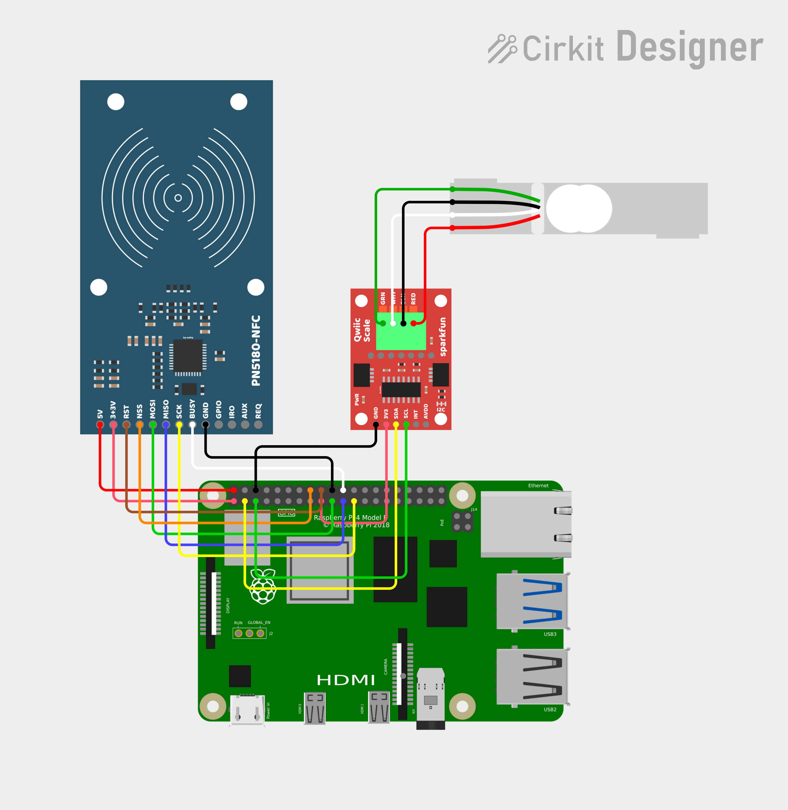

Below is the Fritzing-style wiring overview showing all SpoolBuddy components connected to a Raspberry Pi 4.
SpoolBuddy Wiring Diagram by ouihq
Diagram created with Cirkit Designer. Components: Raspberry Pi 4 Model B, PN5180-NFC reader (SPI), SparkFun Qwiic Scale NAU7802 (I2C), 5 kg single-point load cell.
Verify GPIO pins for your Pi model
All diagrams on this page are based on the Raspberry Pi 4 Model B. GPIO pin numbers and physical header positions are consistent across most Pi models, but always cross-reference against the pinout for your specific board at pinout.xyz before wiring. Some combinations (e.g. Pi 5, Pi Zero, CM4) may require adjustments.
PN5180 NFC Reader — Pi GPIO Wiring
The PN5180 communicates over SPI0 with a manual chip-select on GPIO23.
Dual voltage requirement
The PN5180 requires both 5 V and 3.3 V connections. Do not connect 5 V to the 3V3 pin — this will damage the module.

NAU7802 Scale ADC — Pi I2C Wiring
The SparkFun Qwiic NAU7802 communicates over I2C bus 1 at address 0x2A.
I2C bus 1
SpoolBuddy uses /dev/i2c-1 (GPIO2/GPIO3). Make sure I2C-1 is enabled in your boot config.

Load Cell — NAU7802 Wiring
A standard 4-wire load cell connects to the screw terminals on the SparkFun Qwiic NAU7802 board.

Wire color convention
Most single-point load cells follow the color convention above. If your load cell uses different colors, refer to its datasheet. The key is matching excitation (E+/E−) and signal (A+/A−) correctly.
